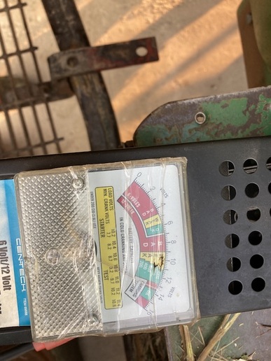

I dont think the alternator on my Oliver 1550 is working. The battery is only a couple of months old, the amp guage shows a small charge but it doesnt put out enough to keep the battery charged. I put my tester on it after charging for a half hour and it showed 13.4, then I started it and opened throttle wide open and it read the same.
It has a voltage regulator, not sure if its the alternator or the regulator
