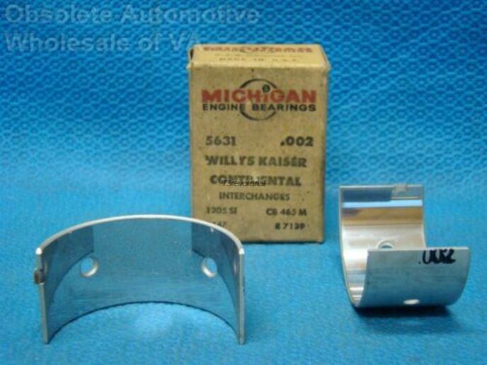

Michigan Rod bearings for an F162 Continental
Posted by stevieb49829 on June 01, 2023 at 11:12:43 from (72.168.160.45):
I'm working on rebuilding a 1945 F162 Continental out of a MH 101 Jr. The polished standard crank came out so I need .002 undersize rod bearings to keep my oil clearances at less than .003. I found and bought some NOS Michigan bearings for the even cylinders. They are 5475 CAP .002 and they plastigauged at .002 clearance on those rod journals. I need to find a set for the odd rods (1 and 3), but I can't find any Michigan 5474 .002 to use. However, these in the pic came up on eBay. They are described as fitting the 162, but are they really interchangeable?
