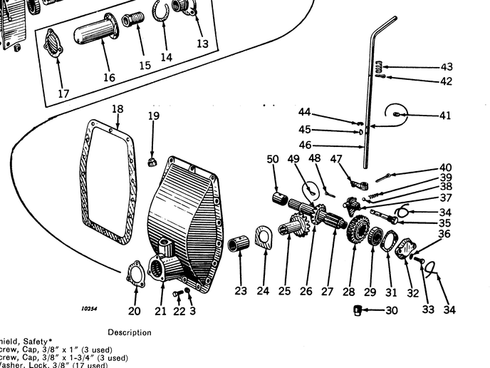

Re: 1939 John Deere B, PTO lever loose
Posted by 2rich4me63 on May 15, 2023 at 05:34:42 from (70.96.206.91):
In Reply to: Re: 1939 John Deere B, PTO lever loose posted by Bassman619 on May 14, 2023 at 07:07:24:
Have you checked/changed the rear end/transmission oil? In my opinion, that is a must. Second, if your tractor has a flat back and you have drained the oil in rear end, its not a big deal to take the rear plate off and take a look. Then you know what you have and can see if there are any other issues. Be careful taking off the plate so you can reuse the gasket.
