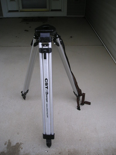

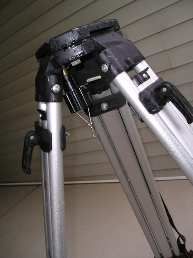

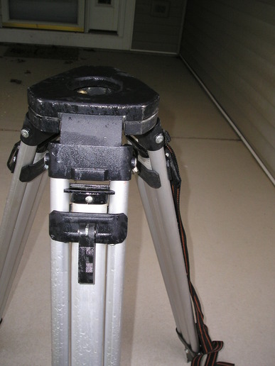

With a project coming up for this spring I purchased a used CST model 136 Transit Level and a used CST/Berger Tripod from the same seller. When we finally got around to working on the project, the transit level and the tripod are not compatible as the transit level base has female 1/2-20 in its base and the tripod has a special 5/8-11 'bolt' for connecting to the transit level. As expected, CST/Berger made many models of both transit level and tripods. My research leads me to a model ALC20 tripod. That schematic parts diagram breakdown shows parts number 2-610-A09-026 Clamp Handle as the correct 'bolt'. No supplier of that part number can confirm 1/2-20 thread. Any help is greatly appreciated.
