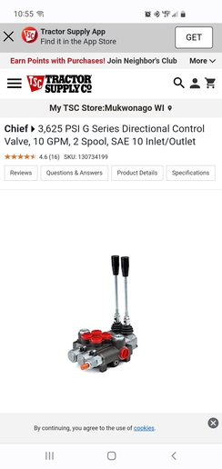

Hi everyone. I installed a tractor supply
Chief four position valve on my Superior
Loader. The Gresen valve I had was 3
position so I didn't have power down on my
lift cylinders. The pump is crank mounted
and the oil reservoir is in the loader
frame. My question that I have is there
any adjustments I need to make to this
valve setup? I have to fully pull the
levers all the way forward or back. If I
don't the tractor bogs down or stalls. My
other valves I could feather so I could go
slower if needed. Any information is
appreciated. Thanks (1957 Ford 860
tractor)
