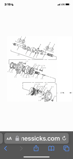

Re: 4630 fwd, broken wheel hub
Posted by Muir hill 101 on April 21, 2023 at 14:22:09 from (174.230.201.148):
In Reply to: 4630 fwd, broken wheel hub posted by benjimr on April 21, 2023 at 14:15:40:
If the housing is broke one of the gears in the planetary
has locked up or lost teeth and grenaded and caused
the housing to break .
