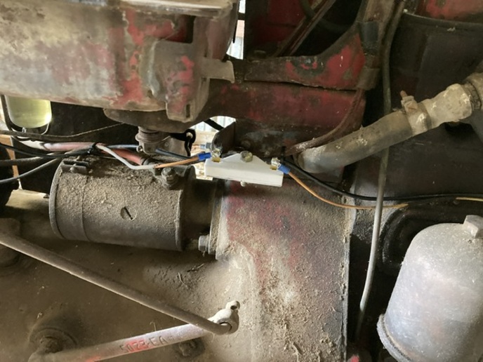

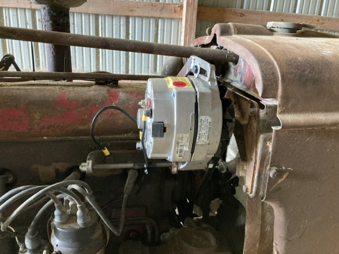

I converted a Farmall H from 6 to 12 volt and added a 1 wire alternator. All together and running but Alternator isnt charging. Im not sure if turns fast enough to get it to start charging, I went full throttle and it didnt start charging. The belt is too wide for the pulley on the alternator and rides half the belt width above the pulley. Im going to try a narrower width belt that rides lower to see if that speeds it up enough to get it to charge. There is a ground bolt on the alternator, I made a wire for it and hooked it to the motor but its rusty. Not sure its getting a good ground , maybe thats why its not charging?
