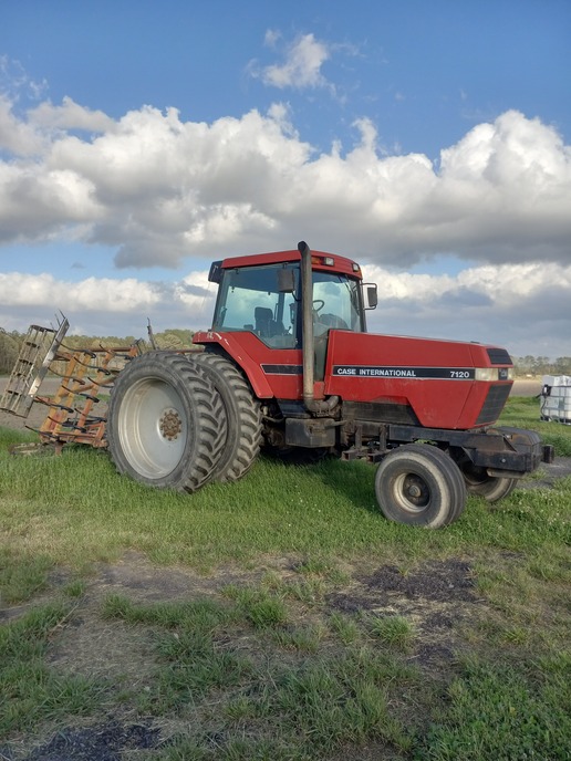

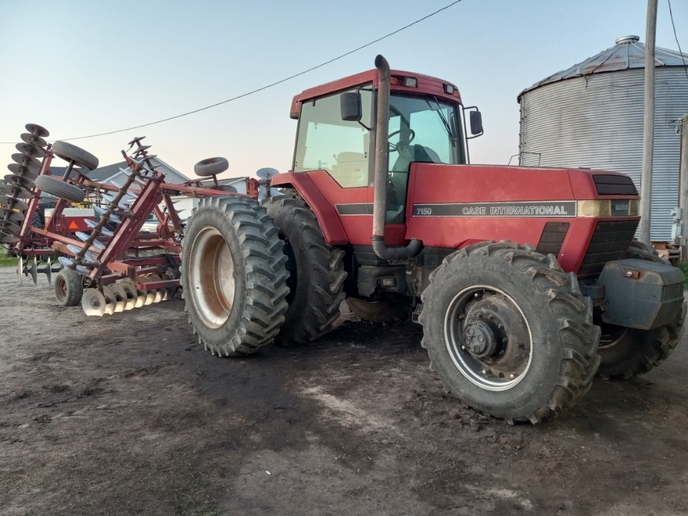

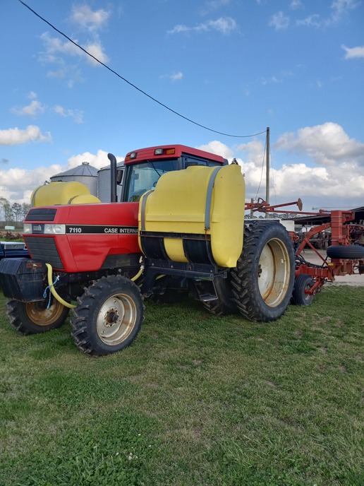

They are as a whole good tractors. We have a 7110 with 10,200 hrs, a 7120 with 12,500 something hrs, and a 7150 mfwd. All were bought used to this farm. The 7110 gave us and the dealer fits for awhile with the cross piece in the differential when it initially went out. All of the replacements were not heat treated and hardened unbeknownst to anyone other than CNH. Once the dealer and the area blockman got together after the 3rd time with 25 to 75 hrs runtime per repair, they put new 7120 guts back into the rear end. It's solid now. The 7120 hasn't required anything other than regular oil changes, filters, and such changed. The 7150 just received a rebuild on the turbo and injection pump at 8k hrs. Otherwise it has been flawless. Talk about a powerhouse with that tractor !!
