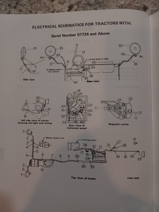

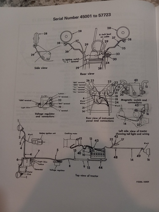

The first 2 photos are for the very last 140s made with the factory alternator and hazard flashers on the fenders.
The next 2 pic's above is for the next to last wiring schematic that was used. This setup utilized a factory 12v system with a generator and hazard flashers on the fenders. There were a total of 5 different wiring changes in the 140 production run to my knowledge. Hope this helps.
