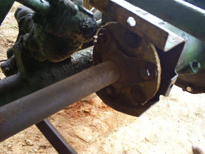

The driveshaft on my 80 year old friend's JD L are actually called couplers.
They are made out of thick belting material.

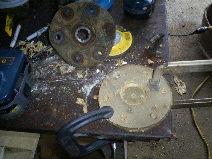

The old ones were in terrible shape.

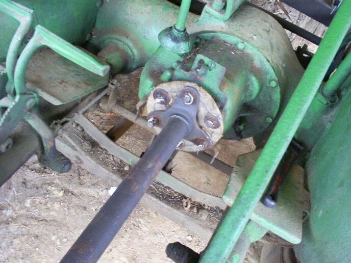

We took some heavy belting material and made 2 new ones.
It took both of us to get everything put together, but we got it done this morning.
Hooked to a Farmall Cub and pulled it around for about 10 minutes.
The oil pressure was great and pegged the gauge.
Now he can finish assembly and crank her up.
He is very happy.
Richard in NW SC
