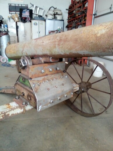

Slow but sure--The Cannon Greenhouse cannons are getting done--They open April 15th so I still have a month and a half to get them done. I don't sand-blast or paint in my shop--Loren the Case guy and I discussed this and I told him of my CBS paint booth and he said--what is that?--Told him Clear Blue Sky--He liked it!---Tee

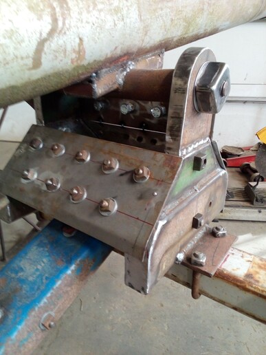

Putting bling on--
Armor plating--

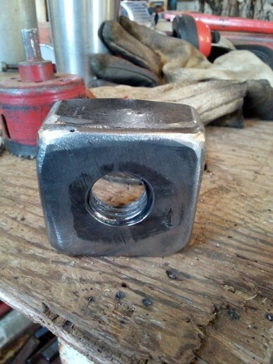

Rear view-I bought a gallon can of square nuts on a sale years ago and they finally came in handy--homemade 2.5 nut

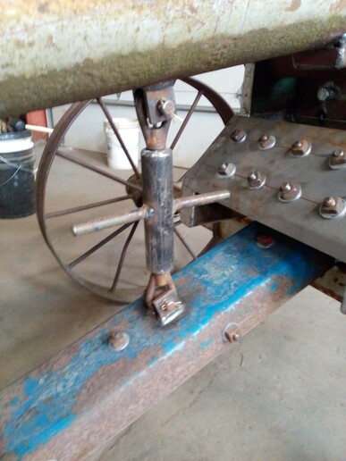

Turnbuckle for adjusting range--made it from 2 dual eye nuts and some pipe--both with right hand threads--

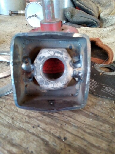

Made the big nuts by taking square tubing and welding hex nuts inside--Sorry for the poor welds--Galvanized nuts and rust don't weld real good--
