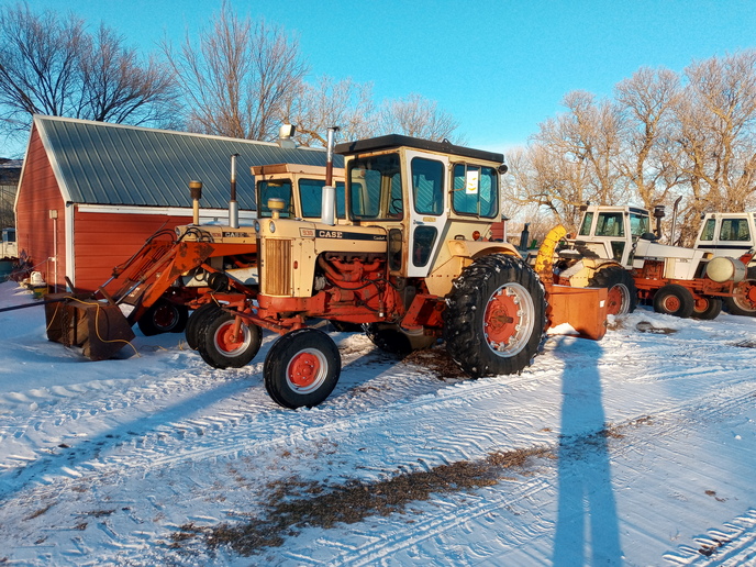

I have a JI Case 930 lp tractor. Ran it today blowing snow...no anti-gel needed. Starts good at -25 on vapor and switch to liquid after the engine warms up Uses a third more fuel than the 930 diesels and not as much power although the diesels are 401 ci and the lp engine is 377ci. Back in the late 60s lp was .06$ and diesel was .15$.
