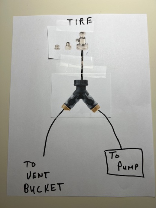

I am not at home to take a picture of my setup but this is basically what it is. You still need the Gempler adaptor but the Y adaptor allows for faster venting. Turn off pump, close pump valve, slowly open other valve to a vent bucket. Close vent valve, open pump valve and start pump.
I had the Gempler adaptor and I might have $15 in the Y and various hose adaptors.
