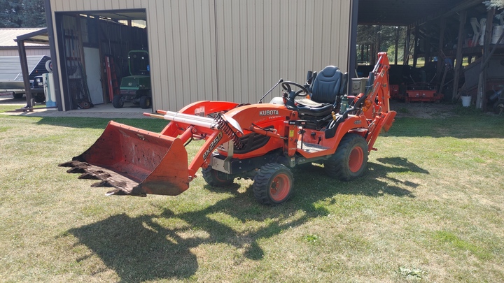

Interesting on the movement after letting off pedal. Mine was doing that. I found a nut missing on a ball pivot underneath up by the hydraulic filter on the back. Once I got that replaced and tight, it quit the movement. Mine is at 670 hrs.
