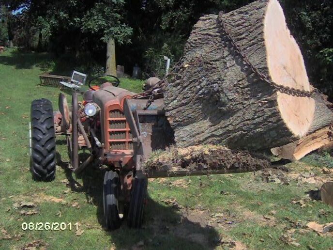

They were an early attempt at a quick tach
loader. On the pre 1965 Fords you could
drive up to it and attach/detach one in
just a few minutes.
The 65 and later models were wider so took
a bit longer.
Yeah, you needed some weight on the rear
and yes they tended to tip the tractor.
They were not a loader for heavy use but
still pretty handy. The pretty blue one in
the photo this morning I lifted about 1500
lbs a couple times. Couldn't drive the
tractor but was able to back the trailer
under the load and set it down.
The one with the big snow bucket worked
real nice when I tore off the old shingles
on the house and reroofed it. Parked the
bucket under the eves and slid the stuff
into it.
Not saying they were the best loaders
around but still an interesting piece of
engineering.
With ths right mounting kit they fit on
half a dozen different models too.
