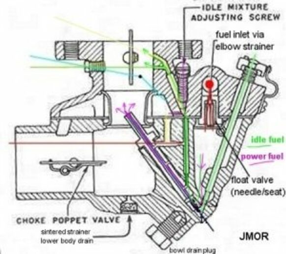

here's a picture of the fuel circuits in the MS carbs, from 'How to Rebuild MS Carbs-Route 249
That complicated mess at the bottom right is where the junk usually stops up the gas flow.
