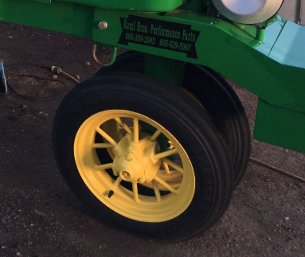

These are re-rimmed. Center hubs are from a 37 A JD and the blank rims came from a company called Hey Wheel out of KS. Did them myself. $40 each for the
blank rims.
