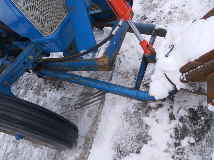

I have an OEM Ford snow plow on my 3000.

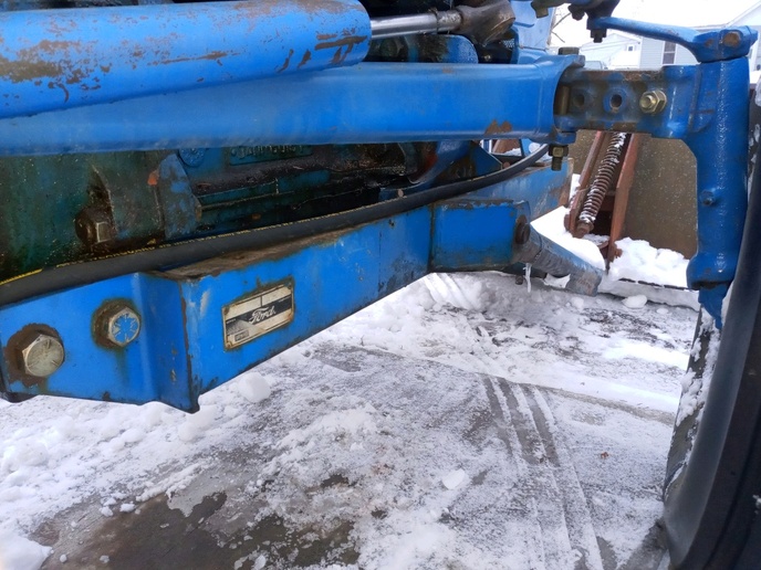

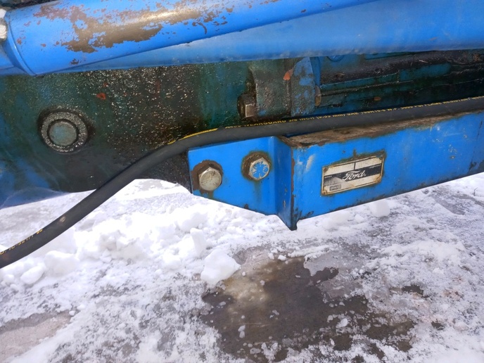

They bolted the sub frame to the lower bolt holes on the front of the transmission.

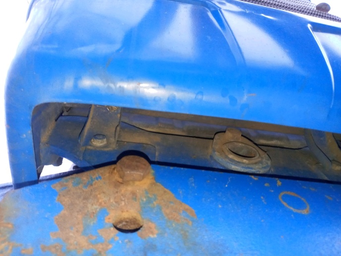

The front of the sub frame bolts on to the bolster under the valance below the grill.
Photo only shows one bolt but there is one on each side.
Ford just used a cylinder to lift the plow.
To get power angle you will need to get a dual remote
I used mine today.
We had about 3in yesterday.
