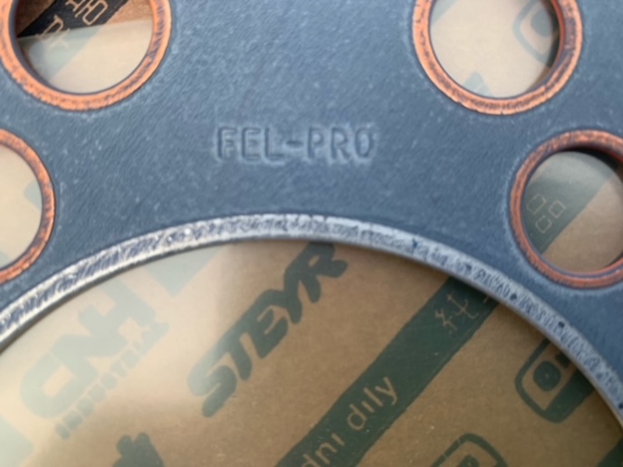

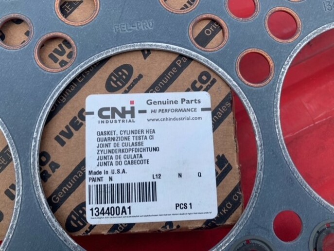

Posted by andy r on January 16, 2023 at 18:52:18 from (208.126.193.44):
Farmall 706 diesel with the 282 glow plug engine had been exchanging coolant and combustion gases. Number 2 cylinder was showing signs of coolant from below. Fire ring on # 2 and gasket materials looked compromised. Bought a new gasket Saturday and installed today. New OEM gasket from CaseIH dealer is a FelPro as per pictures below. $212.00. I did this head gasket 7 years ago and when cleaning the head Saturday I could see FelPro stained/imprinted from the old gasket. Of course it was the mirror image. Cleaned threads in block with bottoming tap. Checked bolts and lightly oiled before install. I was under the impression from many on here that an OEM from CaseIH would be a Victor gasket. Maybe it was several years ago.
