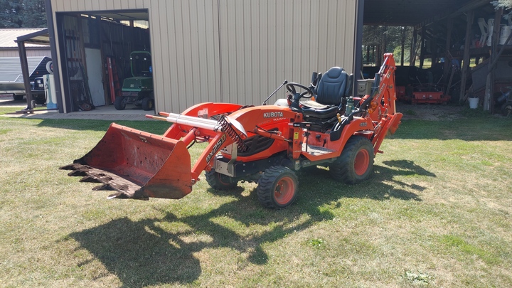

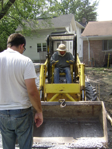

Without pictures, hard to tell, but I'm pretty sure the edge on the back blade is bolted on. Just remove and drill holes in loader and bolt on. I made 2 cutting edges for my 4' Kubota and bolted them on. I also have 2 5' grader blades for bolting on my skid steer. I prefer bolting so I can change between smooth and teeth.
