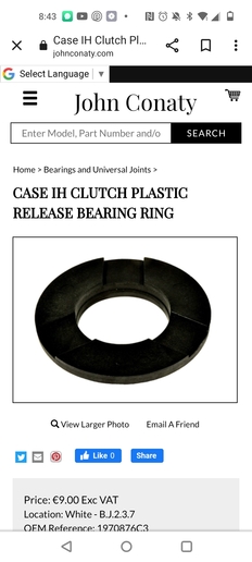

I just came across this plastic bushing on the interwebs looking for parts. I've never seen anything like that, what's the deal with that?
It would explain the gap between the bearing and pressure plate.
Although, I didn't remove anything like that when I pulled everything, so maybe it wasn't there?
