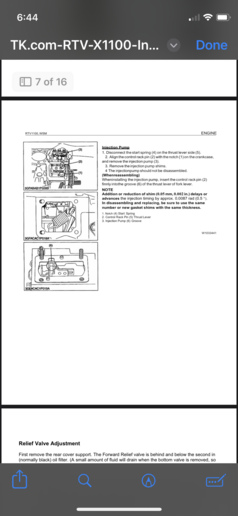

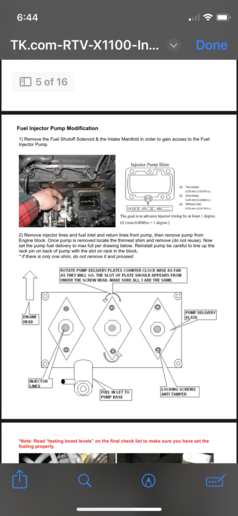

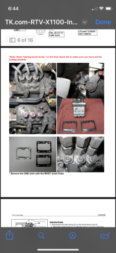

Assuming the turbo is similar to the one in the link and the engine is similar attached are the pump adjustments from the turbo kit we did.
