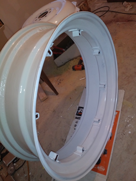

- If you take care of those rims now you
will get many more years of good service
out of them. Flats not withstanding.

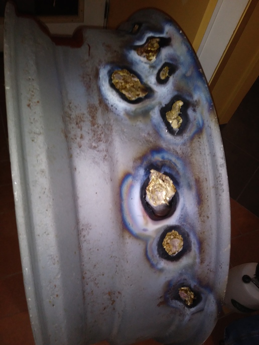

- It is not that big of a job to repair a
set of rims. Get them sand blasted, repair
any rust through - even if the patches
aren't that pretty - then brush on a coat
of rustoleum primer and a couple coats of
paint. That will make them last for many
more years.
- Calcium Chloride is still the best bang
for your buck when it comes to adding
weight.
- By the way, those 3 cylinder Ford 4000s
are outstanding old tractors.
- Here's one of a pair of rims from my own
Ford 4000. I did as I suggested above. Then
Of Course I put the calcium back in.
