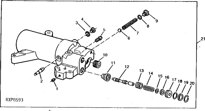

I replied to your video on YouTube. You can also email me here too. I will gladly walking you through checking the three point out. We can try through email or I will gladly send you my phone number in an email. I will not post it here anymore. LOL
I really think you have an internal leak. The dead give away is the lift arms going up and down on there own. I also bet that as soon as you shut the tractor off the arms drop pretty fast. Like is posted on YouTube look in through the filler cap while it is running and the lift is trying to lift up. There should not be much oil dripping down from the lift housing. If the packings or orings are bad like I am thinking you will see oil spraying all over the place.
The oring and backup ring that usually leak are #18 and 19 in the picture. They go on plug #17 and all of that is held in with snap ring #20.
