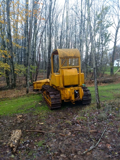

You have to be careful ice and snow don't pack in the track chains. If they do the tracks can come off or worse things start to break. That's why some track pads used to have holes in the middle. I wanted to buy snow pads for my dozer but they don't make them anymore so I torched holes.
