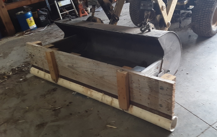

It was made from Free scrap materials.
This pusher was my prototype pusher.
I can remove snow on the lawn and not
damage the grass.
This pusher floats over uneven surfaces.
If I'm not careful the back blade on my
Kubota will leave a pile of gravel when
the snow melts.
This redneck pusher leaves very little
gravel.
I even put 3 inch pipe on the back blade.
When I hear the pipe come in contact with
the gravel I raise the blade to leave the
gravel and a little snow behind.
I've never had any luck using the loader
to remove snow without damaging the
driveway.
My homemade pusher floats up and down plus
one end can go up and the side go down.
Please post pictures of your homemade
pusher or blade.
Always looking for a way to make a better
pusher.
