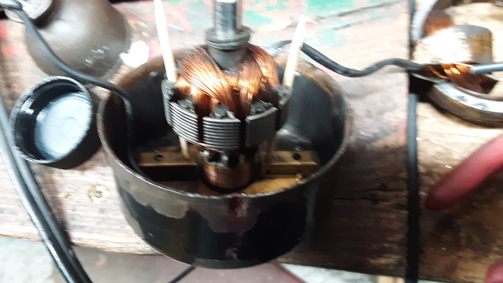

You should have let me get my meter out of the truck and do a little testing.
Running half speed is a head scratcher.
Only guessing, something inside the motor is causing excessive current and burned out the switch.
A motor has to come up to full speed to produce a reverse EMF or the motor will draw excessive current.
Only guessing, your start windings are not disconnecting which could be caused by the end switch welded shut.
