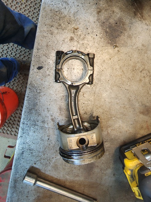

This one came out of a little 3 cyl Mitsubishi. It bent the rod enough that the bottom of the piston was hitting the crank at the bottom of its stroke. My guess is it had gas in the combustion chamber and hydrolocked. We didn't get any history on it. A new rod, gasket set, and carb kit and it runs good.
