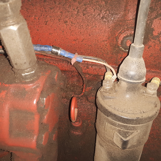

I used a diode to wire around the ballast on my Jubilee.
Prior to using the diode the
Jubilee would take longer to start.
Sometimes I had to get off the starter, battery voltage
increased and it would then start.
A good battery solved low cranking voltage.
