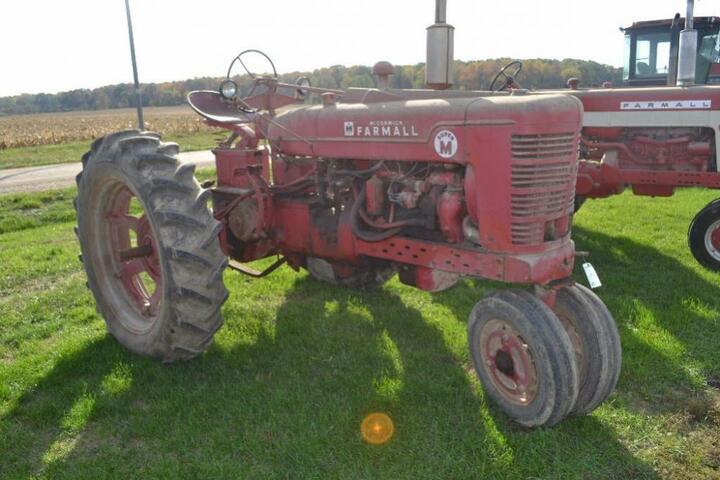

I popped this one loose using a 50/50 mix. I took the rockerarm shaft loose, made sure all the valves were closed and added pressure to the mix via my air hose and compression tester adapter. I had it loose in just over an hour, and running the next day.
