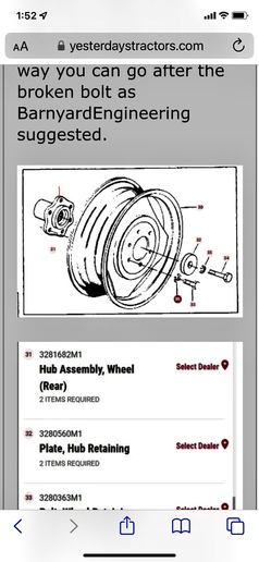

In my opinion when a bolt is stuck that tight
penetrating oil is only making you think you are doing
something to help loosen it. I realize there may be
limited access but I put a red line on the photo by the
top bolt hole. If you can smack it there fairly square on
with a 2 pound hammer repeatedly would help. If
limited access if you can get an air hammer an go at
those points by each bolt may help. By doing this you
are slightly deforming the threaded hole around the
bolt for a few milliseconds. Also smacking the bolt
heads sharply again using the 2 pound hammer may
also help. Smack you finger a bit first so you are good
and mad. ; > )
