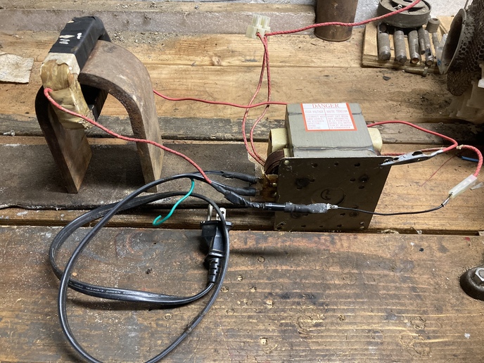

Here is complete assembly ready to go. The primary (heavy windings) is wired for a plug for an ordinary 120v outlet. The breaker is turned off and the transformer plugged in. Flip the breaker for two seconds and turn it off. Some transformers will trip the breaker automatically, but in either case the magnet is done. Set magnet on a piece of steel before charging, and leave it stuck to something the whole time you are working on the mag, to help it retain its magnetism. To get a secondary winding to put on the magnet, take another microwave transformer and cut the welds holding it together, then gently remove the secondary without damaging the varnish insulation on the windings. The last part you will need is a diode... does not need to be any particular value, just a little on the large side... the one shown is about as big as a pencil. If you are stealing it from a board, unsolder instead of cutting because the legs are going to be really short as it is, unless you buy a new one.
