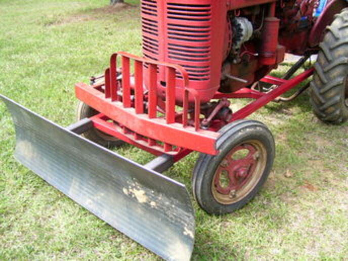

The blade I built several years ago. It attaches to the rear final drives with bolts and the lift is attached to the right touch control arm. If the link to the touch control arm is rigid, instead of a chain, you will have down pressure on the blade which is very beneficial.
