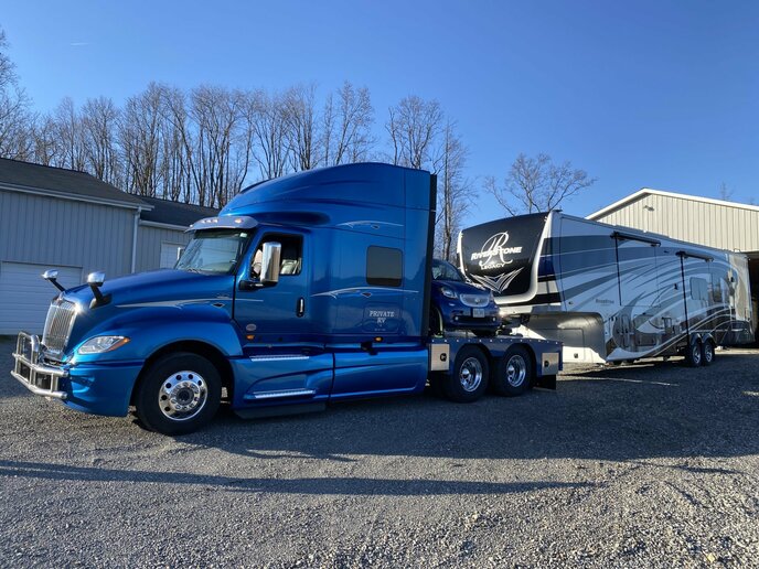

This may not be the best picture but the rig is pretty level overall when hitched.
