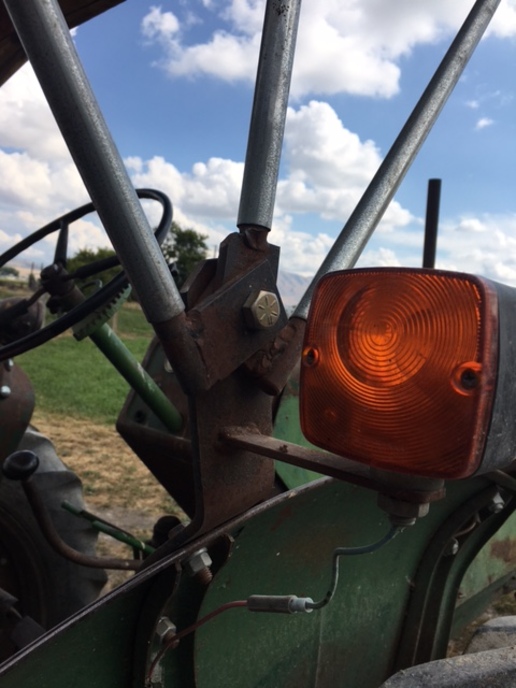

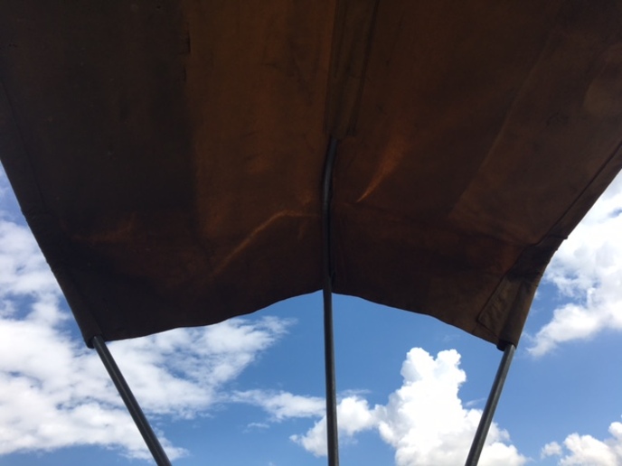

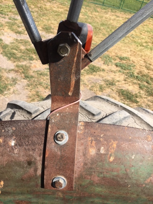

Hay, It has been a while since I have seen a store bought canopy and I am sure that they are made pretty universal to mount on many fenders. I am sure your massey fenders would be good to mount one on. The one I have on my old style 88 is a homade one. I will add a couple pictures if I can. I just used some 1/4 by 1 1/2 steel strap and some 1/2 round bar. Then I got three 10 foot lenghts of heavy EMT conduit and used my pipe bender to make the bows. I had a friend that does upolstery sew up the canvas. The next one I make I will have him make the canvas bigger and spread the bows farther apart. Seems that all my Ideas get out of hand. So while I was at it I added lights to the mounting bracket. It is made out of 2 x 1/4 flat strap. The bows pivot on a 1/2 inch bolt and the wrench stays in the tool box under the seat. It would take a pretty good wind to do any damage to this one.
