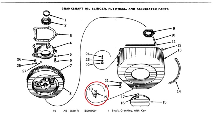

Does anybody happen to have a picture or a link of this in the parts catalog
Take a look at the CRANKSHAFT OIL SLINGER, FLYWHEEL, AND ASSOCIATED PARTS diagram below on page 20.
Note the Shaft, Cranking, with Key (Key 19).
Also note that this part was designed for early 1947 tractors serial number B201000 and up.
Hope this helps.
