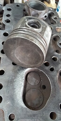

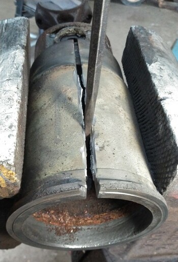

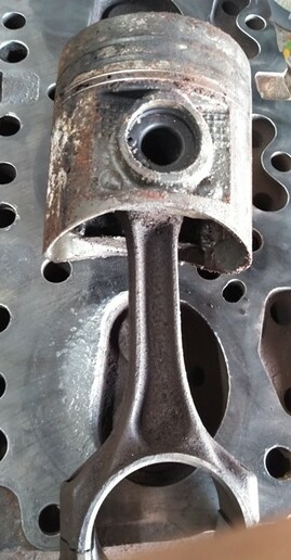

Yellow project #4 301 gasser is cleaning up a little at a time. Was able to get two pistons and liners out without much problem. But the one that was seized up is really stuck good. Had to press the liner out with the piston. Then I had to split the liner to get the piston out. The rings were stuck in the piston just as bad.
