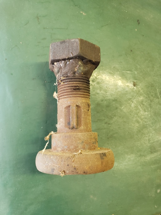

My sq72 is 1&11/16. Go figure. If this is the first time you've pulled the blades you may want to consider this. The bolt is keyed. I got a new bolt and nut, threaded it 2 threads and welded it. I pull the blade nut, screw this on, and the mushroom sits above the deck so I can use a 9 lb sledge to ease it out.
