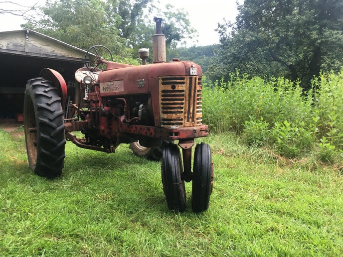

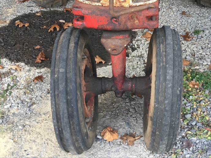

After reading the comments on my previous post, doing a little additional reading and having a good look-see at a Farmall H at the WV State Fair, I decided to pull the front wheels all the way in on my 350. Pretty easy job after all. For some reason I thought the wheel weights and maybe front hub would have to come off, but not so. Pulled the wheel, tilted it so the 3 oclock lug fit over the hub disc in behind and then the other two lugs at 7 and 10 oclock slid right over and in behind.
This wheel change was one of the easier repairs on the farm
Pic shows before and after.
I believe the front end now has that classic Farmall look.
Thanks for all the help!
