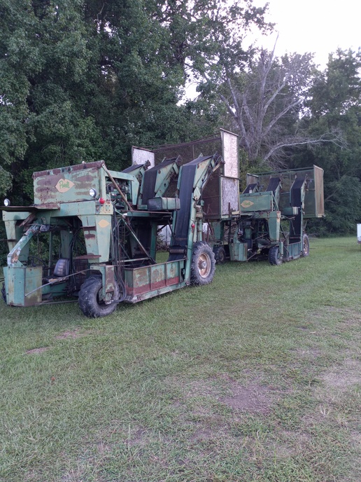

We have 2 of these automatic tobacco primers that run the JD 219 diesel engines in them. During this hot spell 1 of them was running considerably cooler than the other one, albeit neither were in danger of running extremely hot. I got to looking and the only difference I could find is the cool one has the radiator fan drawing in fresh air through the radiator towards the engine, while the hotter one pushes hot air from the engine through the radiator. Both engines have the cooling system of a JD 2640 tractor. Why would the hot one be setup this way ? Is it common to be able to interchange the fan air flow direction on these engines ?
