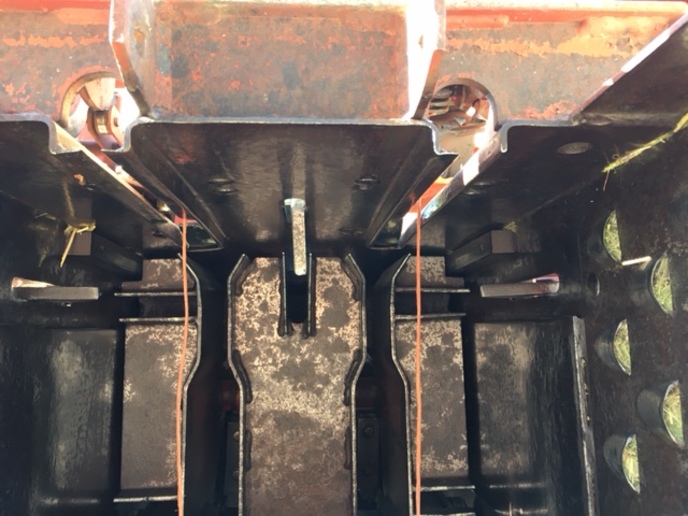

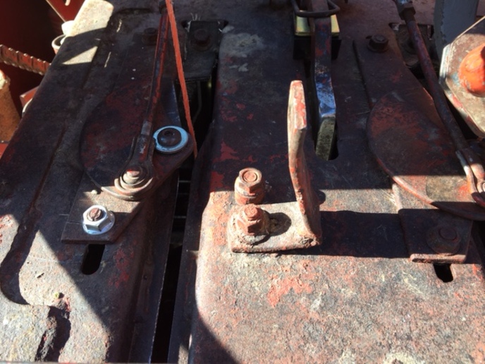

I have a 4650 aka 8550 Case/IH that does not tie sometimes on left string! I have noticed that the bale chamber is different just below the knotter on the left. String misses getting over the bill hook because it is held to the left by the weldment in the slot of the bale chamber. Maybe you have one of these we could compare. It is serial # 0000002 !!!!!! If you look at the right edge of the twine slots. You can see that the left slot has a narrow piece of steel welded to it on the right side. But the right slot does not have this weldment. Help!!
