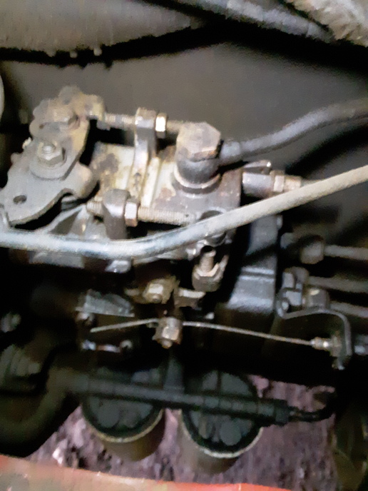

Thanks RedMn, that's exactly what I was looking for. Yes, is part #32 in diagram. I Guess I never thought it could be a rubber piece! I was thinking of a metallic/copper ring. Paul
Here is a couple pictures of the leaking fitting and where the tube ends on the injection pump.
