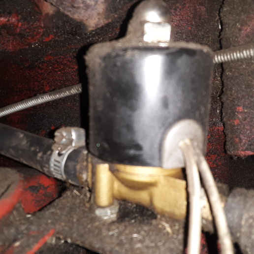

I would connect a rubber gas hose to shut off.
Put the hose in a gas can and drain the tank.
Replace the sediment bowl.
Install a 12v inline solenoid.
Never worry about turning gas on and off.
Finding out you forgot to turn the gas off and finding all the gas it the pole barn floor is an expensive mistake which happens more often the older you get..
