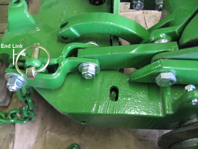

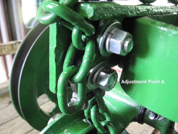

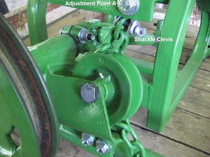

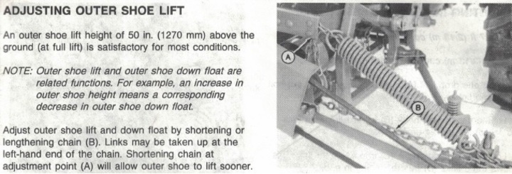

How do I adjust these 2 chains?
Take a look at the information on page 41 of the operator's manual.
Take a look at the photos below of this 9ft 350 mower.
Note the shackle clevis to make quick, easy adjustments.
Note the end link on the chain.
Hope this helps.
