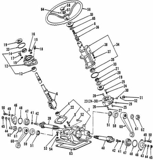

If you have PS fluid pushing out of that
vent in the lower column it means the lower
seal #14 in the diagram below is leaking
and needs to be replaced. You will also
want to replace the upper seal #35 while
you have it apart. To get at it you need to
pull the steering wheel and the fuel tank
cowel
There is a bit to it all but if you would
like some help email me your phone # and a
good time to call. I could talk you through
it.
