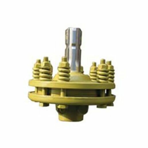

Sounds to me like it was stuck for the first 80 acres, but once it broke loose now it slips, so you need to tighten it. the instructions with mine say to loosen it at the beginning of the season and slip it a little, and then tighten it to the recommended amount, they give a spring length when tight. I mark mine with a felt pen so I can tell when it slips, it should just a little when starting a Bush Hog. Does it look like this?
