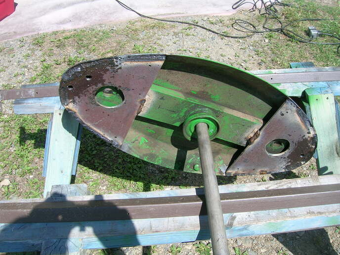

Are you running the tractor up to PTO speed? If you run it too slow the blades will flop around more. We have a Bush hog and I am quite disappointed with it. For one thing, the stump jumper should always be round, not oval. We have a lot of rocks and stumps and I had to repair the stump jumper a few years ago. More recently I put a new skirt around the back, the old one was so thin it would bend in and the blades would hit it. I put these gussets in the stump jumper to prevent it from bending so easy.
