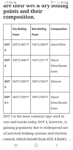

Primarily DOT 4 has a higher boiling point than DOT 3. It is recommended to avoid mixing them.
