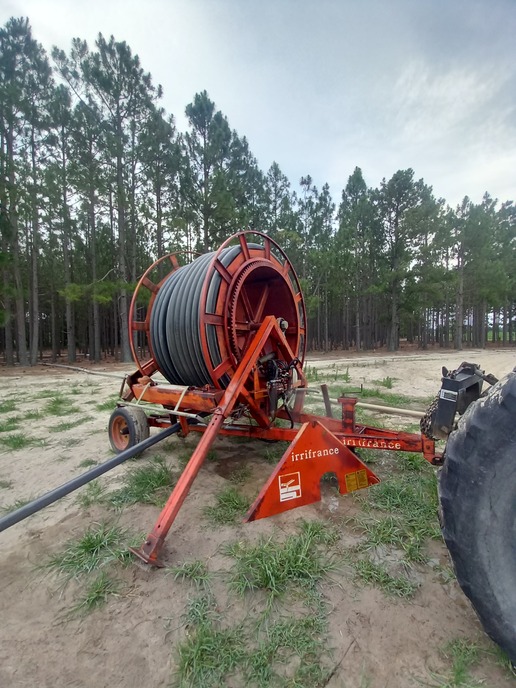

This isn't a tractor but it seems to take half of em to irrigate. Lol. We have a Irrifrance model DPY 90 S reel that is winding up extremely slow even on wide open setting. Everything was working fine until after we replaced a badly leaking sediment can. I've tried bleeding it and tightening the bellows exhaust spring with no change. It doesn't exhaust the waste water fast enough. Any ideas ?
