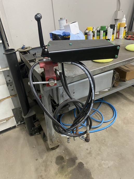

The loader is original to the tractor but has been operated since 1977 off of the rear remotes. Several months ago I bought the cessna two spool valve and bracket from a john deere dealer. It came off of a tractor equipped with a 145 loader. Is there a way to tell if it is an open center valve? Surely its not, but maybe so! Loader operation is good. At low RPM when tractor is hot there is just the slightest hint of chatter but clears up with increased throttle. I've attached the best picture I have of the valve, although you can't tell much due to the bracket.
